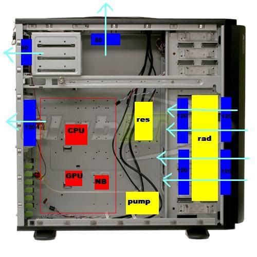

i'm finally building a water cooled system and i just wanted to run the parts on here for other opinions first. all these parts are going to be going in a thermaltake armor:
pump- liang ddc2 with petra top
rad- PA120.2
res- EK-RES150
cpu- fuzion
gpu- MCW60
NB- MCW30
tubes- 7/16"
fans- 2x yate loons
i really want to only spend about $300-350, but $400 is the MAX i want to spend for parts and this brings me exactly to $400 (+/- few dollars). if i had to lower the performance just a little, which part should i sacrifice for a cheaper one? i know i would save 60 bucks if i got an MCR220 instead... but the thing is i'm only doing this once and never plan on upgrading this WC, so i want to do it right the first time. i don't want to cheap out on parts, but don't want to empty my wallet either.

5) i will be using all stock case fans and an additional two yate loons. two will push while two will pull air for the radiator, with the stock fans close to the mesh and the yate loons closer to the inside of the case on the rad. would it really matter that much to have air inside the case going through the rad and out of the case or air from the outside going through the rad into the case?

5. Wont matter too much i would have thought

5) after i had blocks to the CPU, GPU, and NB, there shouldn't be anything that produces heat other than the HD. that means air temps inside the case and outside will be relatively the same, so then it shouldn't matter to have intake or exhaust from the front right?
6) my parts won't put out TOO much heat. for now, i only have a 7900gt and athlonX2. AMD runs a little cooler. and NB won't put out enough heat in the loop to make a significant difference i don't think. i had to suck it up and went with a PA120.2 instead of MCR220 since i had 3 blocks to cool.
my goal for this project is to have everything inside the case. i like the clean look of it so i don't want anything sticking out or hanging. there is no way to fit a PA120.3 internally, otherwise i would have gotten it. and since i'm getting a double rad instead of the triple, that's why i chose a push/pull fan setup for the rad to have more air flowing through. all the yate loons are going to be the high speed version with fan controller in case i want to lower the rpm and noise. this whole fan/rad setup is pretty much equivalent to a triple rad thermochill with low or medium fans only on one side right?
