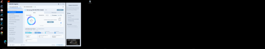

Thats easy then. Download samsung magician from here.
If you can get it to boot to windows successfully without doing any more damage to it, then install the software, open it up and click the diagnostic scan tab on the left and then choose to do a full scan for the scan mode and then click on start. This should tell you if its good or bad. You can post a screenshot of the results if you want.
snag
drive health-good,10.7 TB written
how you take screen shot ?
do you think i should get 980 PRO SSD and replayse the olld one ?
i click diagnostic scan,it say this drive is not suported.

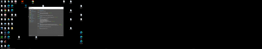

Then the next thing you can do is check to make sure there are no missing or corrupted windows operating system files. Open an elevated command prompt and run the following command, just copy and paste it. sfc /scannow and then hit enter. To run an elevated command prompt search for cmd.exe and right click on click on run as administrator then paste that command. This may take awhile. Let me know what the results say.
snag
it was saying found bad sectors and fix them.
i save the report it is long.you wont me put that up ?
johnb35
Administrator
So your hard drive is starting to fail. I would probably run that scan one more time to see what the results are. Have you tried restarting the pc to see if it boots to windows every time? Anytime a drive gets bad sectors, its only a matter of time before you'll get more, so it would be in your best interest to get a new hard drive and reinstall windows to it. Do not just clone old to new as you don't know if anything is actually still corrupted. I would also invest in a battery backup if you continue to have power outages.
