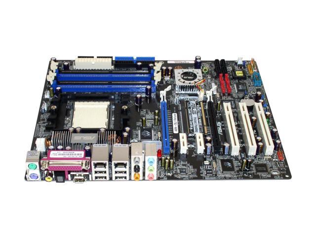

I just recently bought a new ASUS A8N-SLI Deluxe mobo and i have some memory questions about it.
in order to get memory to work in dual channel, which slots do i put my 1gb (2 * 512) dimms in?
from my understanding it doesnt matter as long as you put then in the same color. ex. both in blue, or both in black.
nope if u ave 2 sticks u must only put them in the blue ones as stated in the manual, ull get a beep code error otherwise.
Sli WooDy is right its the same for my premium.
To quote the manual " When using two DDR DIMM modules, install into DIMM_A1 and DIMM_B1 slots only"
DIMM_A1 is the closest to the processor and DIMM_B1 is third away. (The blue ones).
Hope this helps!
