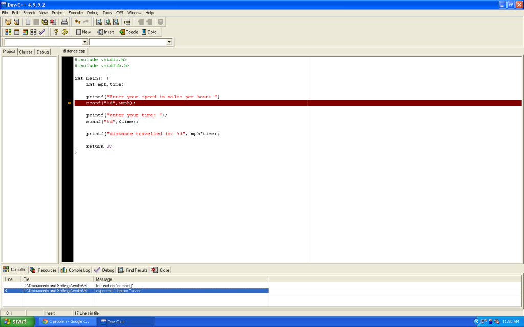

I do not understand what the problem is. Eclipse is telling me that the program contains errors but I do not know what is wrong with it! Can anyone help??
Cheers
What is the error you get? There is nothing syntactically wrong with your program. It runs fine using gcc.

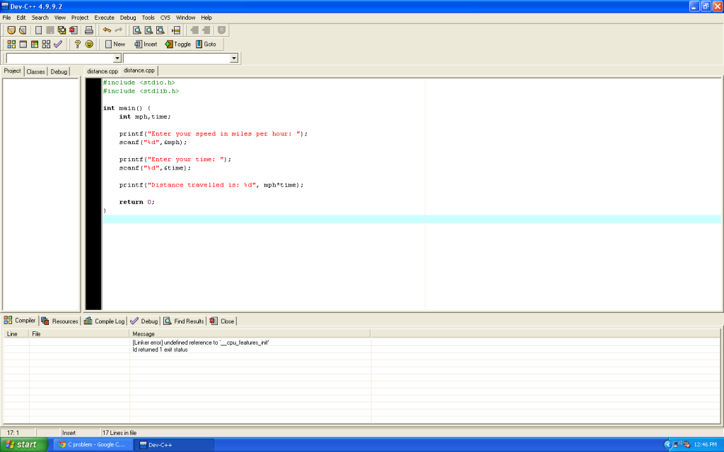

I got an error from it in dev-c++. Shown below.
If you are bent on using an IDE, then uninstall MinGW, and delete the folder completely.
Else, use a terminal:
Going to have to agree with the terminal statement. It's way overkill if you are doing something simple like this as it just over complicates things. Write it in the text editor of choice and then compile it from the terminal/command prompt.
Worked fine for me as well:
