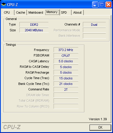

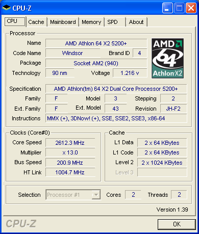

here is my CPU-Z I feel that My ram is not running on 800Mhz, but My friend tells me I am becuz I am running on a dual core so everything is X2. so 400Mhz X 2 = 800Mhz
And also My Bus speed seems a bit low. Can some of you tell me what your bus speed is. Also my memory frequency looks weird. Does anyone have the same problem?
Your CPU has nothing to do with your RAM. It runs at 400MHz, so it's totally correct.
Your bus speed is also fine. All current Athlons run at 200MHz FSB.
Memory is running at kind of a weird speed, but nothing to worry about...

  • His ram is running 373 rather than the 400 it "should" be. This is due to the Odd Multiplier in the CPU. You can look into the Odd Divisor Correct for some more stuff

hey, Do u know How I can fix my memory Frequency? Is the ram bad? I need to kno.
What do i do? is there something I need to download. Do I need to update the Bios? I am using a Asus M2N-E Motherboard.
You're memory is running at ~DDR2-746, which is most likely caused by a lowered bus or a memory divider set incorrectly.
How do i make the ram do DDR2 800Mhz?? What I got to change?
The 5200 runs your ram at 746 because of the CPU X of 13, cant be divided even! If you want it to run close to 800 set your HT back to X4 and bump your FSB up some
Faster, just a couple of MHZ at a time, but at 746 theres not really much performance difference than at 800
