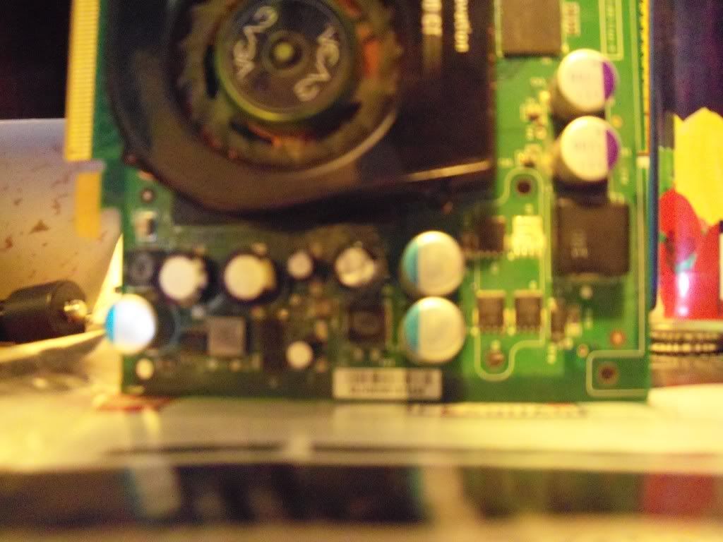

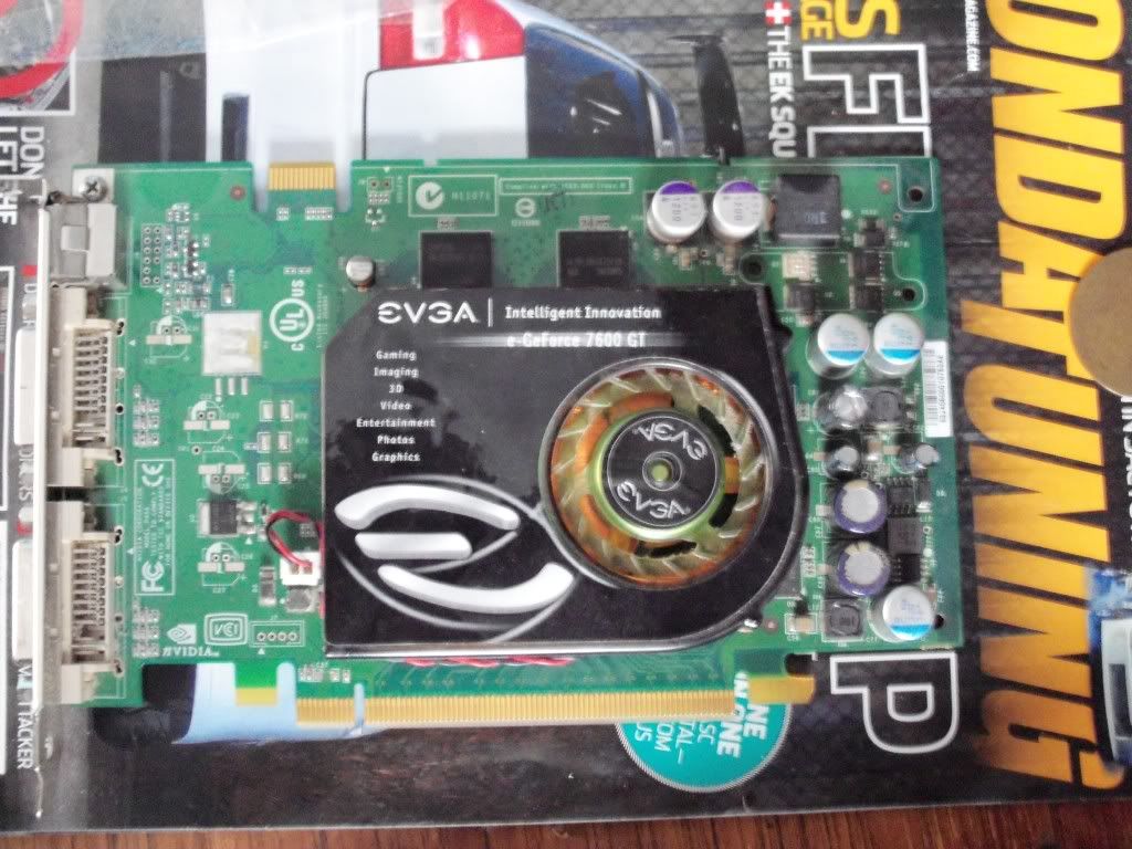

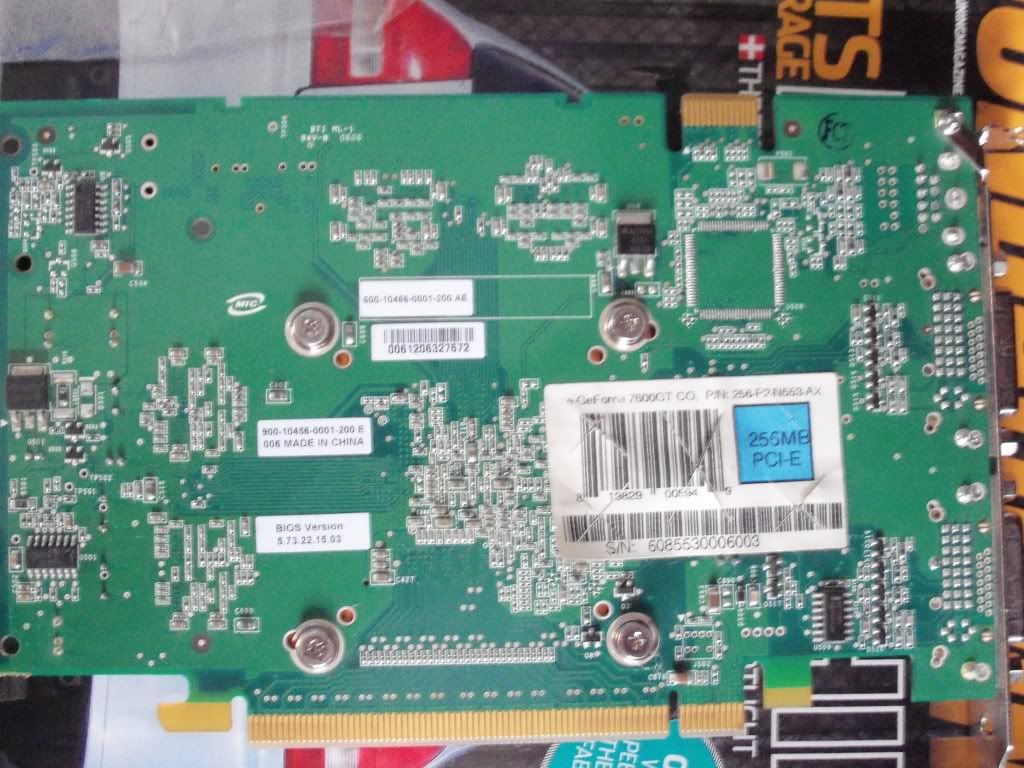

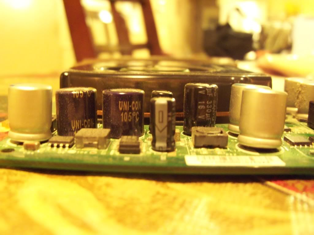

If you can take pictures of the card and closeups of the capacitors we can help identify if they are blown or not. Or if you know what to look for, I'd check that. Cause if they don't RMA it and it is blown capacitors, it's an easy fix.
Well it turns out i don't got lifetime warranty on the card :( due to me being stupid and not registering on evga once i bought it from my friend. Well got to learn from my mistakes. Anyways i still don't know if its the card that shot out or my pci-e port stopped working.
