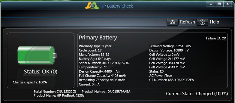

I have this laptop for almost two years. It stays powered on about 14 hours every day, always plugged in. On occasions i use it unplugged, i get a whooping 6 hours of backup, even after two years (if all I'm doing is Firefox, with "power saver" profile and screen brightness set to 0. On Windows 8. Strangely, battery dies MUCH faster if I'm using windows 7 - 3.5 hours, performing the same Firefox browsing, i dual boot)
I have this software called "HP Battery Health Check" , came pre-installed with Windows 7, it shows here i have cycled the battery only 18 times in all these days. Always used it plugged in, and I get 6 hours of backup, with battery health at 100%.
So then, on laptops about two years old or newer, is it at all needed to remove the battery while plugged in? Of course, my personal experience lets me strongly believe it isn't, nevertheless, what do you people think? Is this an exceptional case? or is this true for all present laptops and removing the battery is just a waste of time.
