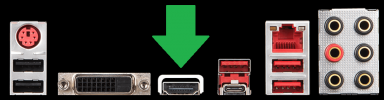

Once i remove the gpu how do i connect a screen.. the gpu has the hdmi ports.. and where do i place the disconnected 6 + 8 pin cable thats attaching to the gpu inside og the mashine?

You can just tie up the cables to something. Your motherboard should have either a VGA, DVI, HDMI or Display port connection on the back to hook the monitor up to.

skovdam
Okay cant see apperently.
After @beers showed an image and pointing out that i should have to port it appeared before my seight :)
Other than being insanly laggy and almost melting my pc without a gpu the stuttering/flickering is gone..
So now ill try either taking the card apart myself seing if i can see something wrong, send the card to someone so they can fix it or buy a new card..
Thanks everyone and if one of you have a recomendation for a card to get if i go that route feel free to post it :)
