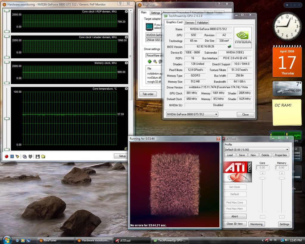

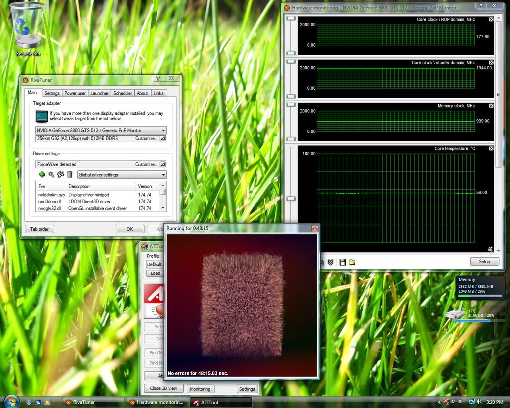

I could never get it stable, so hopefully... :rolleyes:
nice clock!

I haven't actually tested it in a game, but it was stable for like 50 mins on ATI Tool, that should be Ok, right?

amazing clocks! 800core2000shader is wicked!
burned out at 740core 1850shader 1050memory. not gonna dare go higher until i can stick some ek blocks on them and drop the temps a lot with water.
