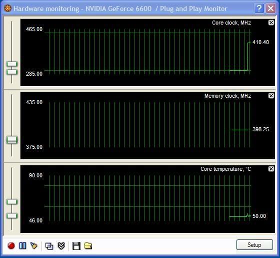

Everest says ~200Mhz
Rivatuner says ~400Mhz
And the Nvidia controls panel says 800Mhz!!!!
On experimentation if I increase the clock via coolbits in the NV Control panel (Shown above) by 20Mhz to 820Mhz then rivatuner goes up by 10 and Everest goes up by 5. So it is in proportion.

Am I right in saying the 400Mhz is the effective clock freq due to DDR
From research the average GF 6600 AGP Mem Clock is 275 but can have a larger range so I assume that the Everest value is the one I want to watch. So it looks like a bought a pretty slow clocked 6600.

Ok, thats what i thought, I think i can pretty much ignore it as they all increase in proportion
So should i aim to only overclock the memory to 250Mhz (500Mhz effective). As this is what i found to be the MAX Freq for my GDDR SDRAM according to Samsung.
