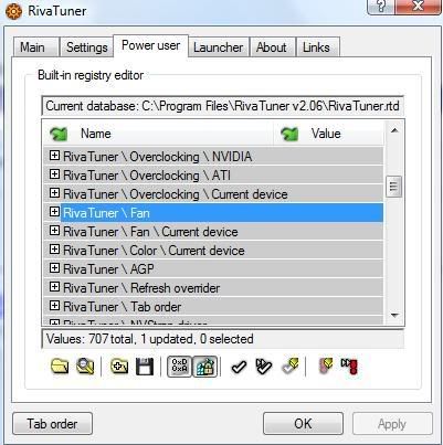

I believe what he meant about a fan on the bottom is an external cooling pad. What I would try first is manually setting the fan speed to 100%, and see if that helps. To do that I would download RivaTuner, once you do that then i'll tell you further on how to do it.
ok, ill install it, do u have an x-fire or IM account? or would u rather just use this forum to help?
