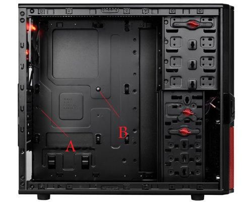

We've got the case plug situation solved, but we're still having problems screwing in the MoBo. We're using the V3 Black AMD Edition.
The cases' manual literally only says, "Lay down the chassis. Install the motherboard in the proper location and secure the screws". It says nothing about brass standoffs and I have no idea what to do with them. I thought they were needed on EVERY screw hole to stop the MoBo from shorting out, but they only gave us 2! As well as 1 spacer, and I don't know what to do with that either.

I'm thinking it might be because of the lifts in the case. Under every MoBo screw hole, the case lifts up. There's only 2 places where it doesn't. One, I screwed the standoff in, and the other(slightly to the right of the center) has what seems to be an upside down standoff(that is smooth, rather than spiraled) that can't be removed from the case. It sticks out a screw hole in the MoBo.
Diagram.
A= the standoff I screwed in.
B=The upside-down standoff.
It also comes with one plastic standoff labeled "Spacer Support"
Are some of the holes raised like a small bump ?
Yes, but I wouldn't call it a small bump. Each screw hole has a kind of raised up ramp. I watched a video on YouTube of someone who got the same case, and they were confused about it too.

Most of the motherboard stand offs are built into the motherboard tray with the remainder included in the standard bag of hardware. One feature that more case manufacturers should adopt is the center stand off with a pin that acts as a guide to hold the board in place while you tighten the screws.
I guess that means we're set to go. Or at least, I hope so.
Where there is a bump you do not need a brass standoff the bump does the same job.
I suggest take the board out, then trial fit the board put it in as if you were going to fit it then slowly lift off and make sure to spot where the holes on the motherboard meet the holes on the case.
If they only included 2 standoffs with your case, you should find all but two holes meet one of the raised bumps, which should leave 2 flat holes where you need to screw in a standoff.
