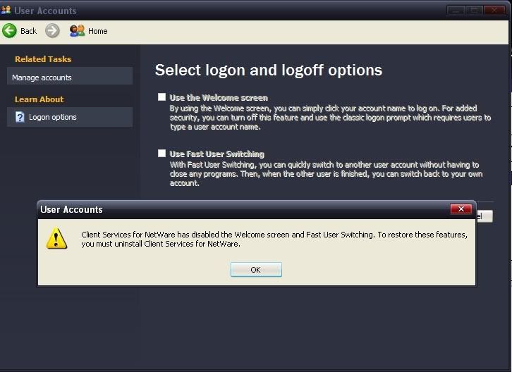

i want to change back to the logon screen where i just have to click my picture. at the moment i have to type in my username. when i try and change back i get this
The only way that I know of to get round this is to remove it from your system. You need to display your network connections (via the control panel), right click on your LAN connection and click properties. Then highlight the Novell entry and click uninstall.
