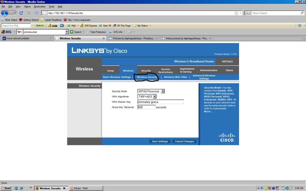

the way there saying after running the setup it would save the wireless name password to get onto the network to make it easier but i perfer to setup the network myself by using the online setup it is a linksys router so go to your internet explorer or mozilla firefox whatever you have type in the address bar 192.168.1.1 go to the WIRELESS tab make sure it is in manual setup mode and the rest you should be able to figure out but if not just holla when you get that done

so the two computers your having problems with are xp?
and first things go into the online setup and secure that wireless
192.168.1.1
it will come to a log in screen
no user name
the password is admin
go to the wireless tab name your network and use a security
192.168.1.1
no user name

i already did that since before but ill do it again anyways. now what should i do?
