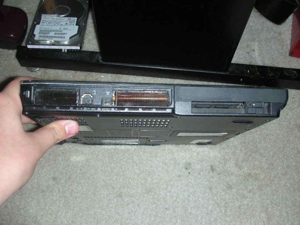

-Cut out side fan grilles to improve airflow(Semi Completed, Need to be smoothed out but mainly done)

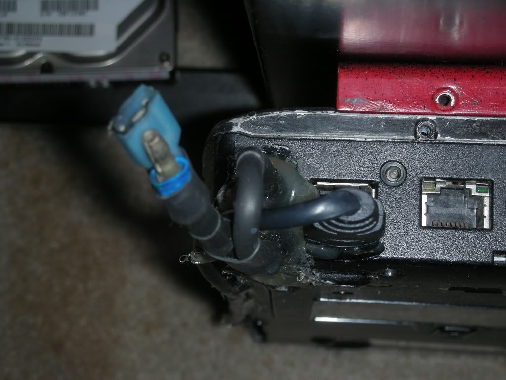

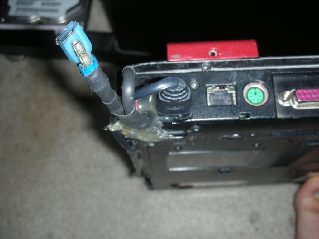

-DC Jack has broken off 3 times, ive replaced it 2 times now. Third time i decided to fix it once and for all, i soldered some 14guage wire to the contacts on the mainboard, hotglued into place, soldered and heatshrunk on quickconnects.(Completed)

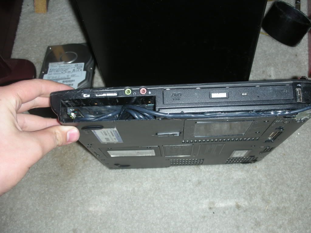

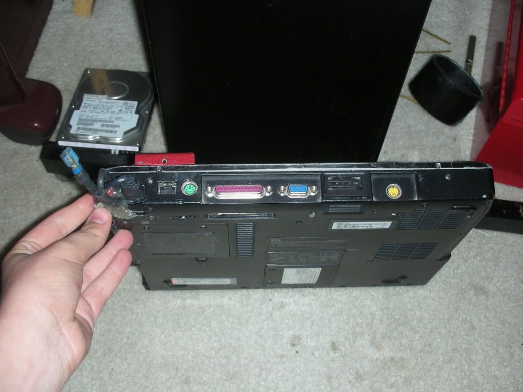

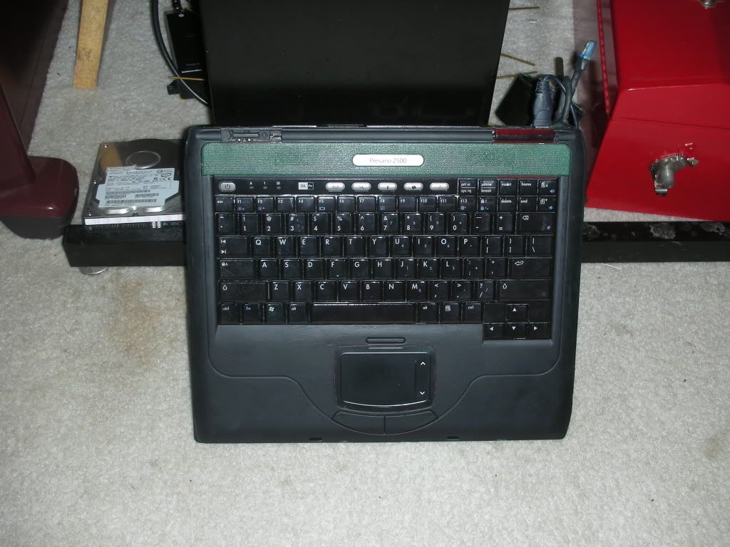

Now, some pics so far:
(Will have the old battery cover over that, the flash drive is located inside there)
^^Yes, the display is currently being painted

Only one of those is the power cable:P The other is a usb extension cable heading to a flash drive(makeshift ssd). I actually have run it that way for over 2 years now, just now redid it though so its cleaner with the glue to insulate everything and heatshrink vs pvc tape.

Whats that cable for?
One goes to a usb thumbdrive as a makeshift ssd, the other is for a hacked together power cable. The dc power jack cost me $15 including shipping on it and i had to replace it 3 times, it was really prone to coming insoldered on these notebooks, either that or the center pin would break. This way it takes a few seconds longer to connect, but i dont have to open the notebook up every 2-3months again.
