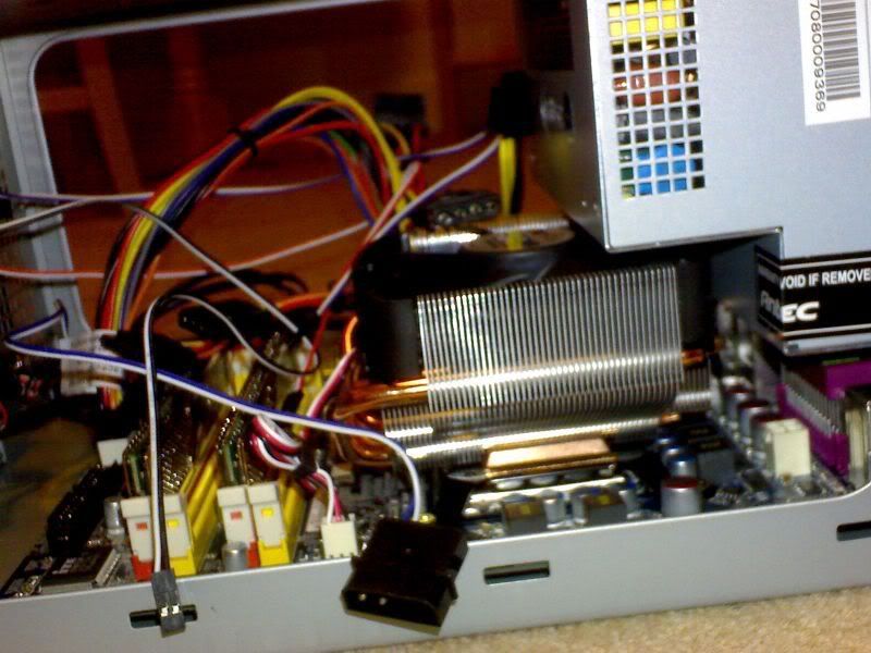

Well, I'm limited by my case being an Antec Nsk1300. Basically the power supply is L shaped, to accomodate for the cpu cooler. Fitting a regular power supply would probably entail cutting the back off the case and leaving it sticking out loads.
My pc is an intel Q6600, a sata optical drive and a sata hard drive.
The power supply is 300w. Antec ar300. Here's a picture if you want to get an idea of the shape:
As you can see, L-shaped and not very big. A bit tricky really. Someone suggest using a vga power supply, but that would use up my only 5.25" drive bay. I was wondering if there are any supplemental power supplies around that are a bit smaller.

Hmm, actually thinking about it the size might be quite a big problem. it's fairly long and possible high enough to hit a hard drive. Looks like I might have made some bad decisions about this case.
