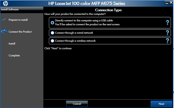

but if I follow your method I have to follow the process of installation and connect the printer to the device.
In my case I want to define a shared printer or as network printer it depends:

The installation above force me to follow the steps of connecting the product to the PC actually I can't connect it because it is a shared printer not Network nor usb connection.
Usually you can just do the installation from the link Okey gave you and it will ask if this is a new printer or just installing on a new system and will set it up properly.
I tried it. It didn't ask whether it is new or just installing. It forced me to follow steps of connecting the product to the PC and my printer is shared printer so that's why I need INF files.

The screen shot I put in the previous post is from my home laptop just to explain but actually is not a workgroup the pc's are joined by a domain. When I tried to define the shared printer it was asked for a driver.
The printer is connected by USB cable to PC windows 7 64bits. The new PC that I want to define the printer for is windows 7 32bits.
