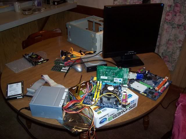

Ok, first off. My setup was...an Intel e2140, Gigabyte GA8I865GME, 160gb Seagate HDD, 1gb cheap RAM, 400W Antec power supply. Ok, I had the e2140 overclocked to about 2ghz for a few months but I didnt think it was fast enough. So, I decided to buy a new motherboard. I purchased a Gigabyte GA-EG31M-S2. I then proceeded to hook it up to all my old components except for ram, since I needed ddr2 for this board(i bought 2gb super talent ram) I plugged it in and hit the power button, and everything started up, except there was no signal on the monitor. I know 1000% I had everything hooked up correctly so I thought, ok, the onboard video might be dead. So I borrowed an XFX 7900GS from a friend, but my psu didnt have the 6 pin needed to power it, so I thought thats why it didnt work with that. So, I order an EVGA 9500GT, and still nothing with that installed. I then thought the mobo was completely dead, so I put in my old motherboard, and it does the same thing. I tried a different power supply and nothing, new ram nothing, I am really stumped here. I think it is the CPU that has went out, what do you guys think???

Having something not connected is not the problem. I have tried it at least 15 different tries with all the different components I have with every combination possible. I also hooked it all up outside of the case on a static bag to make sure something wasnt shorting on the case. Is there any sure-fire way I can test to see if the cpu is dead without needing a 2nd CPU?

This isnt my first time hooking up a pc, so I know my connections are correct. I was thinking about taking it to the local PC shop, but I dont wanna have to pay a guy 30 bucks to tell me something I already know. I have been asking around to borrow a cpu from someone but noone has volunteered yet. I might just buy an e5200 and call it a day, hell they are cheap. Anyone have one they wanna get rid of for somewhat cheap? :) Or anyone with any old socket 775 cpu they dont want, wanna sell it for cheap?
