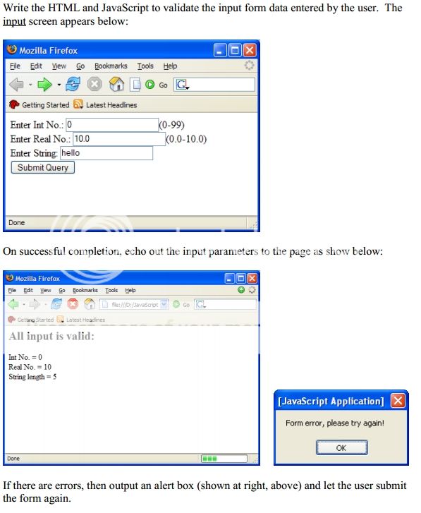

Hey guys, writing a code for class, I think I have it probably 95% done, just need a little help finishing it up.
Here's what supposed to be done:
Here's what I currently have:

As you can probably tell, I'm not getting the correct display. I think my problem is that my Variables are not stated correctly in the beginning, but I'm not 100% sure. Any help would be greatly appreciated!
