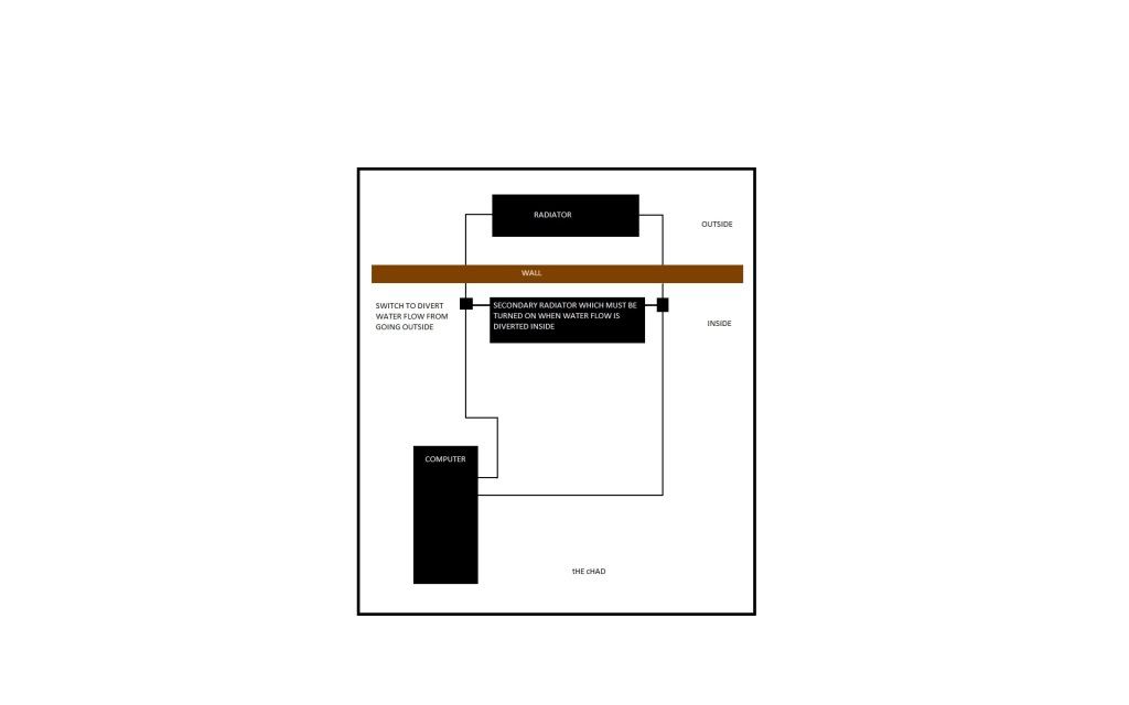

I know little about watercooling and I don't know how to explian this so I drew a picture:
if its going to be subzero temps outside im sure you will come across condensation somewhere along the tubing or inside the case!
what temps is it outside?
1. Condensation is one issue as funkysnair suggested, especially if its going to be a decent length of tubing because it will provide plenty of surface area for condensation.
2. length of tubing is another because for most pumps if your running a high restriction radiator and waterblock, plus tubing you will lose alot of flow, especially on something like a d5 which isnt that great for head pressure.
3. For most pumps that would work well such as an iwaki, its almost required to run hardlines for fear of bursting tubing.
4. Antifreeze is well, antifreeze, it keep the liquid from freezing but also is not very good when it comes to thermal conductivity and capacity.
