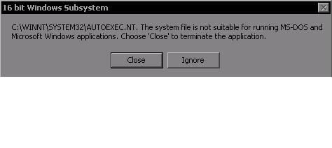

Picture of the message
By clicking on the driver shown there you are brought to the next page for the actual download link seen at http://downloads.lexmark.com/cgi-pe...frame=&fileID=440&searchLang=en&searchLang=en That should go on without problem.
If you have to simply go into the device manager and right click on the Lexmark listing there to choose the update driver option. You would do this if the download doesn't have it's own installer and then browse to where it was opened. You may want to choose the uninstall opttion first and restart the system to have Windows redetect a new device where you ignore that if the installer is included or browse for the needed driver then. Their tech support link is also seen there if you get stuck trying to get the update to go on. That usually takes a few days to see any response however. But that is the driver to go with.
