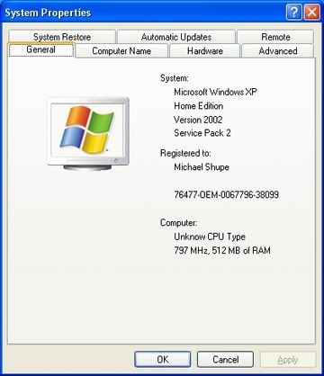

for some reason, my motherboard is not recognizing my processor? it is supposed to be an athlon xp-m 2600+. and right now it is only clocked at 800Mhz. it sucks because i can tell it while gaming and it sux:mad: can anyone tell me what to do to fix this? do i need to flash my bios or what?

i looked in the bios and i could raise the fsb, however i still couldnt get the total speed to much over 1000Mhz, and even then it was unstable. if im not mistaken, this is a 1.99Ghz stock processor. everytime i raised the fsb to 200, my temps were good, but i had to clear cmos so it would boot up.
my mobo: Epox EP-8KMM+
this is not my lappy. i just built a system and its pissing me off.:mad: im thinking it might be the mobo, because i had to install audio drivers cuz i didnt have any audio the first time i booted. is that normal?

Flashing the BIOS often helps these sort of problems, but there's something important to check first in this case. On your board there's a jumper labelled JCLK, which MUST be set correctly (Setting 2-3, I think). Consult your mobo manual for more info. It can be downloaded from the epox website.
I had the same problem with my old Epox 8K3A+, it's this jumper setting that will prevent your processor being detected. If that's not it, a BIOS update may help, but really shouldn't be necessary, as Epox claims to support that processor.
