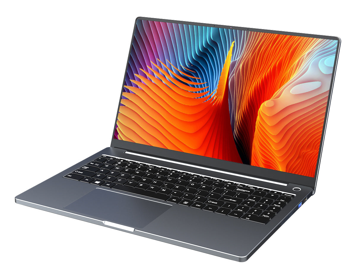

Maybe one of these?

It certainly resembles the
KUU Laitnin G5​
Trying now to see what the motherboard looks like, thanks for this, hopefully there's light at the end of the tunnel.
Cheers, Ray

Nice yo, I just googled the battery part number and that was the cross reference. Seems kind of hard to find any specification information as everything is very Chinese, they don't seem to have much documentation for it.

Thanks for tying I'm having the same problem. it resembled the KUU G5 but not the same. Cheers.
