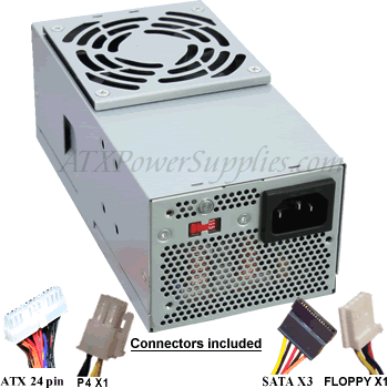

(250 Watt DC Power Supply) Not to good!

Sorry, you mean that my computer comes with a 250W psu, which isn't enough for the card. Makes sense. Two questions. First: could I have damaged the card last night? I ran it for quite a while without incident. Two: how do I solve the problem? How do you replace the PSU?

Thats one of those slim line cases. You could Email Dell or call and see if a standard ATX Power Supply will fit.
Dont think you could have done anything to the card. Dont really know if its the card or P/S, but the P/S is pretty much on the small side power wise.
Just re-read the booklet, says 400W min. How do I go about replacing the power supply? My tower is slim, do you know any website that would tell me compatible power supplies for my dell?

Both times it fixed itself was after it was completely unplugged, more than 5 minutes. This was mentioned as a possible fix on another forum, and it seems it's a problem with the power supply capacitator.
I may just unplug my computer for a few minutes instead of going through the hassle of finding a slim psu.
Yeah its probable getting itself loaded up and and shutting down. If you unplug it and push the Power button a few times it will discharge the P/S. But it will keep happening. Its like running a car with the pedel to the floor all the time, its not going to last long.;)
