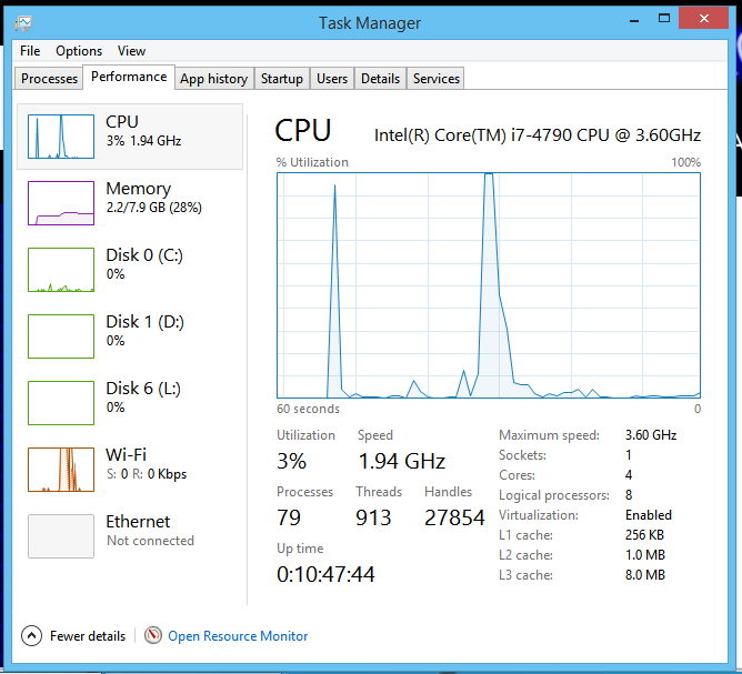

Wireless mouse (Microsoft Wireless Mouse 1000, supplied with computer) gets laggy only when some software is opened.
eg: when I open Chrome, it gets jumpy and laggy and if click on resource monitor it has spiked at very close to 100% when the program started.
Is the cpu spke a concern given the specs?

On the screenshot below the first spike is when task manager was opened and the second when chrome was launched

The screenshot of the resources is what happened exactly when the mouse got laggy.
ie: when the graph hits 100% it bogs down.

Here is what I would do. For the weird thing if the manufacturer had forgotten to attach the usb header to the motherboard, open the case and see if the cable is attached to the correct port. On a motherboard there are usually a couple different usb headers to attach to, but on an OEM board, there might not be.
Try a wired mouse to see if the wireless mouse is the issue.
If you can't figure out the mouse and usb ports then take it back.
