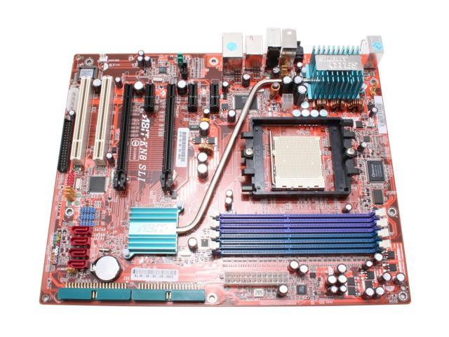

I was thinking about getting the ARCTIC COOLING AVC-NV5R3 NV Silencer Rev.3, but I was worried about SLI problems.
Here is my mobo:
Will it work??

you might want to measure the distance inbetween the two cards and then compare it to the hieght of the Silencer Rev 3 too see how much of a clearance you'd have, if any.
yea i have a silencer... it depends on the board, pretty much just measure how big the SLI bridge is, and then theres like a measurement sheet on the arctic cooling website... mine has like 2-3cm clearance, that is between the end of the fan because it has a little point tip on the fan... i duno my ECS has plenty of room really. i don't see why yours wouldn't.
