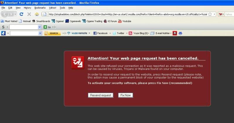

I get a big red message saying
"ATTENTION YOUR WEB PAGE REQUEST HAS BEEN CANCELED"
I ran a scan with malwarebytes, also with AVG free, I could not get rid of it. I also found these instructions off google.

I went into SAFE MODE. But I couldnt find ANY of those files listed. Here are both malwarebytes and HJT logs. thank you for any help you can offer
Malwarebytes' Anti-Malware 1.50
