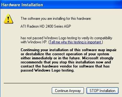

I got this message which is the same message I got when I installed the drivers on the cd that came with the video card. I dont get this cuz on the box it says it supports windows xp, Im thinking about going and getting the 2600 pro or some other card. Paratwa did you get this message when you installed the drivers for your car?
Those messages are absolutely normal, don't worry about it. The impairing and destabilization the message alludes to never happens, it's just M$ being anal.

But yeah, that popup is normal. It just means that Microsoft has not approved them. But they will work anyways.
