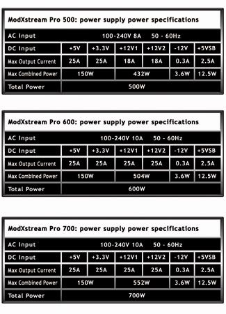

okay, how bout this. I am using a 600 watt OCZ with 50 watts on the 12+ rail. Would that be enough to power a 680 or 2 450's? If not, then what the minimum to upgrade? I don't think I really need 750 watts, but it was a midrange that I could think of.
2X 25 = 50 does it not?
It has 504W and 42 amps on the 12V rail. That 25/25 is just the max any (one) rail can pull without tripping. You cant just add the two rails max together. The 680 has a minimum of 600W and 42 amps which is your on the dot. So with a 680 you would not have any overhead. It would probably work, but it would be putting a load on that OCZ.
By how many watts is has on the 12V rail. In general you divide that wattage it has on the 12V rail by 12. That one has 504W. The amps rated on the rails is just what that rail can pull without tripping. If one rail was pulling 25 amps, there would only be 17 amps left for the other rail. Plus you need to know that the wattage and amps on that one is rated as MAX not Continuous. So it can only pull that 504W under load just for a short time.
When your looking check on the way they list it too. As far as Max or Continuous. Like my power supply. Its rated as a 750W and 60 amps Continuous. It has 720W on the 12V rail and 60 amps Continuous. As Max/Peak it has 825W and 69 amps. They like to cheat and list the Max watts instead of Continuous to make you think your getting more then you are.
