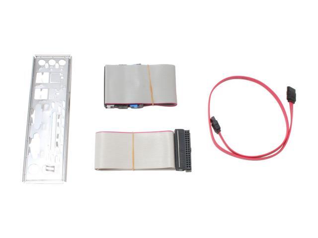

Ohh, Ok, I get it..But..It doesn't seem to be fitting. The motherboards sound and mic ports, for instance, go vertical, but on the case, they go horozontal (when the case is layed flat)
Also, the PS/2 port doesn't line up. There's like 3 things htat line up. The Monitor, and 2 other plugs that you screw something into them, in order to get them to stay in. Monitor is pink, the other 2 ones that fit are tealish-green and blue.
What should I do now? Other people said it was compatible.
http://www.newegg.com/product/product.asp?Item=N82E16811119068 <-- Case
http://www.newegg.com/product/product.asp?item=N82E16813186105 <-- Motherboard
yeah. If I line up the monitor and the other two, then I have The PS/2 Port where the USB Ports should go. The USB Ports are way over where the mic and that stuff should be. Is it just a problem because I have hte mobo set up in the wrong direction or something?
Sounds like they give you the wrong backshield if the sound ports are different and the PS/2 ports dont match up. You can pop it out and run it without one till you get the right one but you have to take the board out to swap them around. Sure you didnt put the backshield in upside down?
Cases come with an I\O shield already in there, are you sure you popped that one out? And then put in the new on the came with the motherboard?
