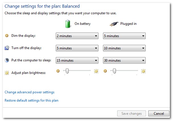

The POWER options in operating system may need to be reconfigured.
There are options which enable your HDD and MONITOR to go off after a certain period of time.
So set the current values to "NEVER" and that should solve the problem.
It looks like this on XP and Windows 7:
WINDOWS XP
WINDOWS 7
