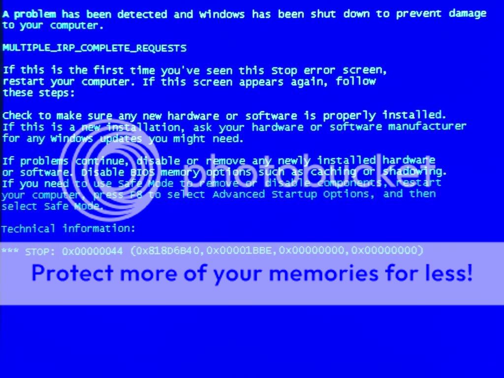

Turned my PC on the other day, after working fine for however long, and now it just continually reboots. But before the reboot happens, I get this blue screen
Anyone know what this means?? It boots in safe mode and in safe mode with networking and operates perfect in those modes. A virus scan revealed nothing. Want to avoid a reinstall at this stage.

Are you using any type of wireless usb device for internet?
Nope.
Take a look here. I know it's for Windows 2000 but it may help you.
http://support.microsoft.com/?kbid=294876&sd=RMVP
Cheers bud. Something I just thought of was this problem has come up since installing Firefox, but not right after the install. IE works fine in safe mode, but Firefox will not start up. I cant even uninstall it. Im using AVG 8.5 and the scan didnt seem to find anything. I'll look into the error code further. Thanks again for your help guys.
D
Ok, for future reference for anyone else having this issue, I uninstalled the video and sound driver and now it works fine. I guess I'll fine out soon enough which one was the main cause, but at least Ive narrowed it down to a driver conflict.
Thanks for the links. Something in there referred to drivers reloading packets twice. Took a punt, it worked.
