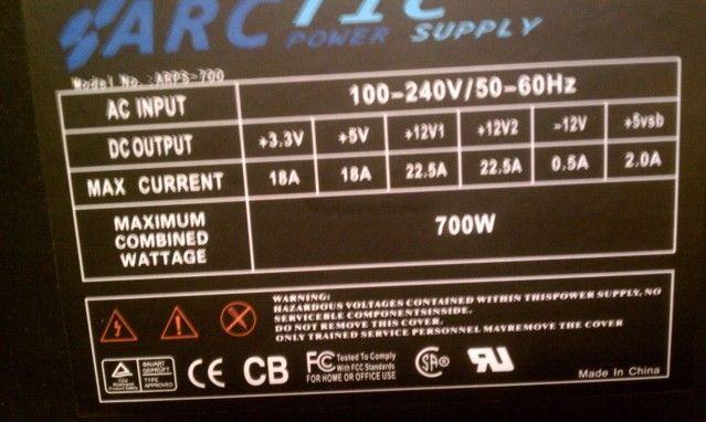

I did some calculations on your PSU and after derating and apply the design standard, it would be lucky if that PSU could provide 13A to your graphics card (160W approx). Not enough for the 12V rail minus the CPU. Remember thats when it shuts down too (assuming it can provide what it says on the tin which it probably cannot).
The CX600 is a good choice. Im glad i pushed you to look into that, it couldve been nasty
