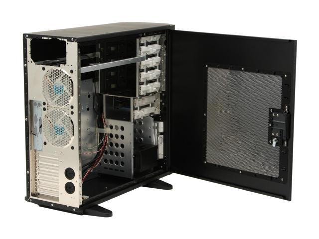

i got these: they're made for each other.

yep no prob, make sure you have a big case you can easily fit in a mid-tower just need some modding, and if you order that one and need any help or questions just ask me im here to help anytime im here
