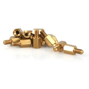

Second, did you use the brass standoffs between the case and motherboard?
If you didn't use the standoffs then most likely the motherboard is shorting out against the case.

i definitely used the spacers for the motherboard. i will try to bend the pins back to order..
