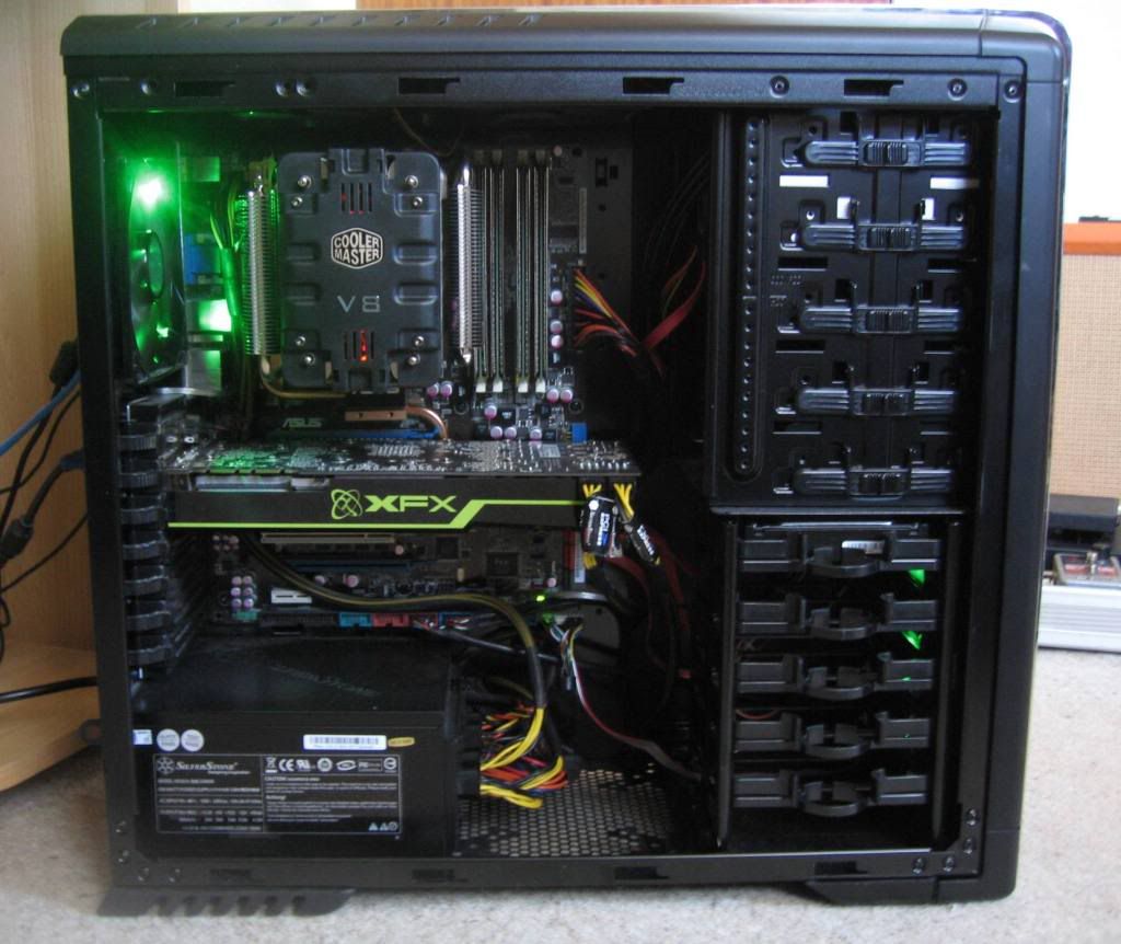

Another question, I'm finally getting around to my new build and have a fitmit issue. I have a CM Storm Scout and my 4870X2 won't fit. I'd have to remove the drive where the HD would go and buy a 5.25 bracket to fit the HD and put it up higher. Does anyone have this case and what did you do to fit your long GPU card. I have the Arctic Cooling Accelero Xtreme on the card to keep it nice and cool. If I took it off, which I won't it would fit snug in there. Any suggestions?

I have the Storm Scout and a GTX 260 which is quite long (10.5" I think), it fits in there with about 5mm gap between the card and the HDD rack. As you probably know the HDD rack is mounted sideways, so if it were me I would cut the rack up the top so there's a small hole for the card to fit through and keep the bottom HDD bays intact so you've still got somewhere to mount your HDD.

To save me money, this is what I decided to do. The 4870 is about 10.5" and would fit, but with the aftermarket cooler it's 12" long. I had to cut the top of the HD enclosure 2" and the back side. But it saves me money, still looks good and when I put the HD back in, it stabilizes it even more. I snapped a few pics. I'll share them in a bit.
Here are a few pics. before and after.
Good work, that's exactly what I was thinking would be the best way to do it. It doesn't look too bad either. If you wanted to make it look neater though you could get some black rubber tubing and cut it down the middle then push it on over the edge right the way around.

Yeap, exactly what I was thinking. I only had the big stuff like 3/4-1" I need maybe 1/4" would be great. Thanks for the suggestion....:good:
