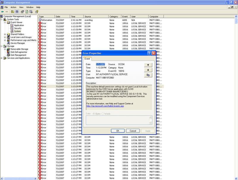

There's a bunch of errors in the system part in Event Viewer. I also got a few firefox application errors, too. I installed all my drivers yesterday from the CDs, so I don't think there's a problem with that. Question: Why would running one stick of memory make any difference? Could the problem possibly be with any lose connections in the case?
