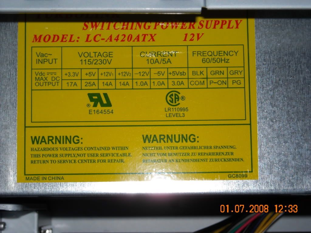

Hi, i am in the marke for buying a new video card, i posted earlier about wether i should get a 4670 or 9500GT, and has told that the 4670 would be a better chiose, but i would like to know if i could geyt anything higher than that?
9800GT? 4830? etc.

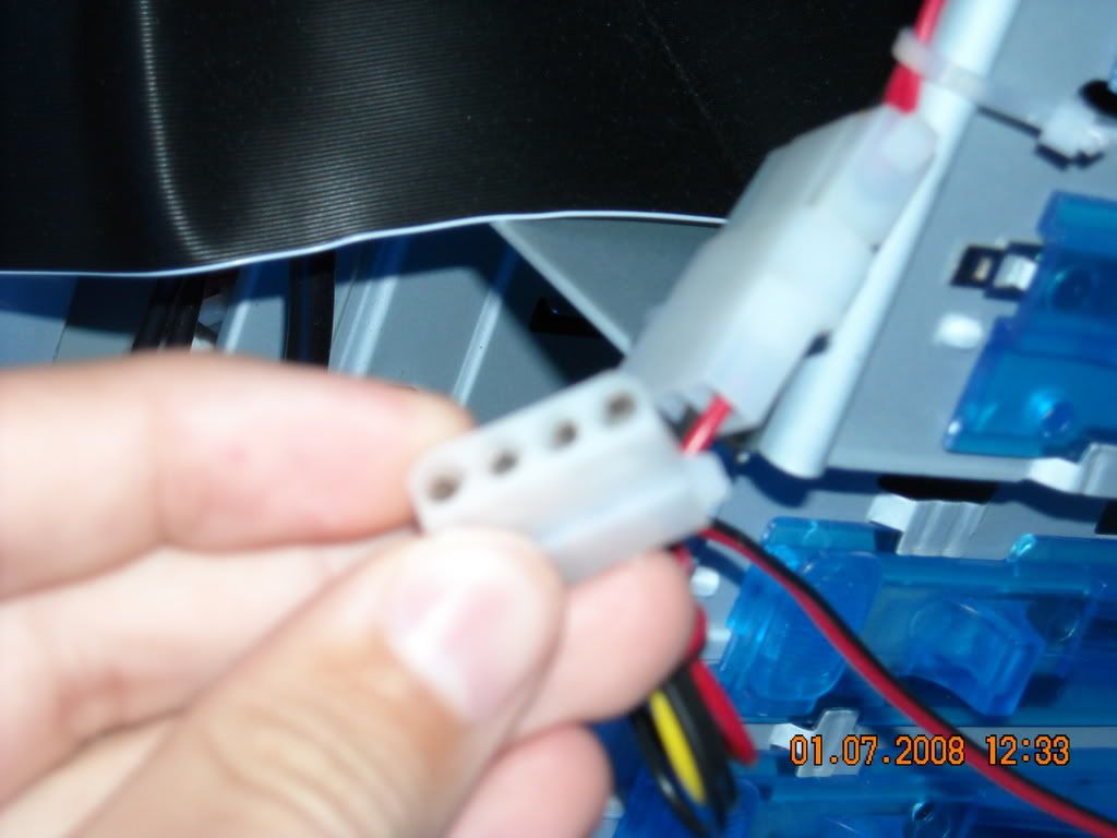

I dont have a 6 pin connetcor on my psu, but i have been seeinf these converters that come with the video cards that go from a 6 pin into a 4 pin.? will this work?
Will a 9800GT or 4830 be able to be put on this psu?

I see some of these cards some with a cable that goes from 4 to 6 pin.
I don;t have a 6 pin on my psu, so would that cable be the alternative?
yes a molex to PCI-E (2x 4 pin molex to 6-pin PCI-E) will work, remember that uses up two molex cables tho. Do you have two spares?

omg don't listen to these idiots. Wattage has nothing to do with it.
You have a psu with a standard ATX design. That means 12V 1 is deidcated to the CPU. Period. That means in lamons terms, 14A (ie 12V1) is dedicated to keeping the cpu happy and at a stable voltage.
That leaves the last (12V2) rail to power the whole of the rest of the system (e.g. hard drives, graphics cards, sound etc etc). That means only 14A (under ATX standards).
AGP require 26A and PCIe requires 32A minimum for correct operation.
Yours has 14A at best (don't even start me about the efficiency of that psu)
Simple answer is NO! Your psu is shit and is way underpowered.
Let me say that again: None of those cards are designed to work with that psu, NONE!. You need to upgrade, forget the wattage on the label.

I agree the P/S he has is cheap and probably doesnt even give the power that its rated for. Most manufactors recomend a (minimum) of 400W and 26 amps (total) on the 12V rail/s for a 8800/9800GT. Bypass the multi. rail bull. You dont just add the rails together to get the total amount of amps.. So it probably has nowhere near 28 amps.
