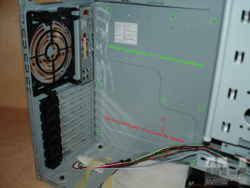

Standoffs? I don't know what standoffs are, but the ASUS mobo didn't come with anything except itself, 4 SATA cables, CD, manual, and the thing that I plugged the PWR RESET, etc. cables into which fit onto the board.
I'm not sure if this makes any difference, but the screws that the case came weren't long enough to make it from the top of the mobo to the threads in the screw holes. I was only able to fit 4 on the right-hand side of the mobo. I didn't think it mattered. Just as long as it was in place and not sagging while the PC was standing upright.
So, what are standoffs? Thanks for the DOA definition.
Thats your problem then.
Standoff
You only put them under the grounded holes on the motherboard.
