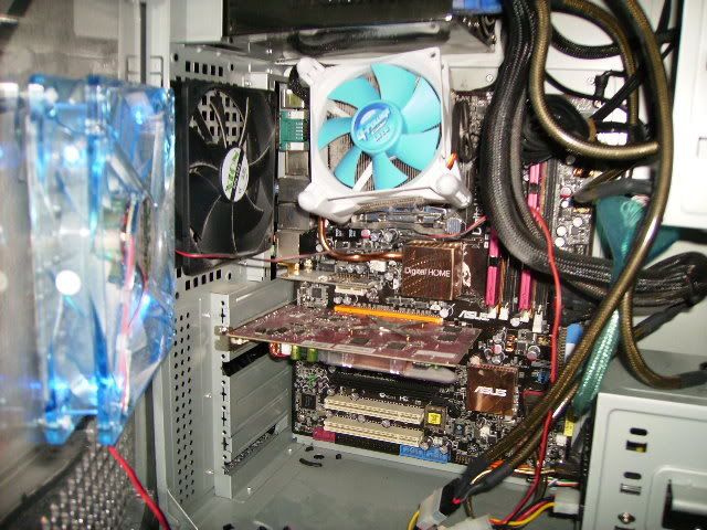

Yeah I slowed it down to 2.93. (I guess that's how you put it.) It's been a little min since I cleaned it. Bout to do that right now. Here's a pic of the guts of my computer.
Judging from that picture the heat sink isn't seated at all just hanging by the thermal paste, as the snap on s or whatever you call them aren't like

Can you get a closer picture of the heatsink? It looks a little wonky to say the least... It may be some cool, funky design though?
There's a fair bit of dust on there too, if you can, get a can of compressed air and blow that motha out!
