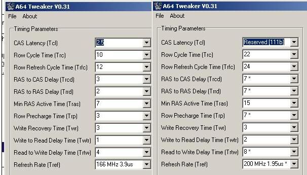

I have 768 Ram in my computer, a faster stick of 512 and a slower stick of 256.
The part on the left is 768 total with the slower ram, and the part on the right is only 512 of the fast ram. I can see that the refresh rate is higher, which i assume is better, but what about the timing?
Oh yeah, with the slower ram, ECC is disabled, but with the faster ram its enabled. The last time I checked it didn't say anything about ECC on the package or ram. Would it be better just to leave only the stick of 512 in there?

It looks like everything but the frequency is better with the slow stick in there. You are probably better off with the 100MHz than the better timings though.
your everest shot is reading 2-3-3-8. unless I'm reading it wrong you've only got the corsair in the everest shot and in the a64 tweaker shot it's reading unknown(probably 3)-7-7-15
