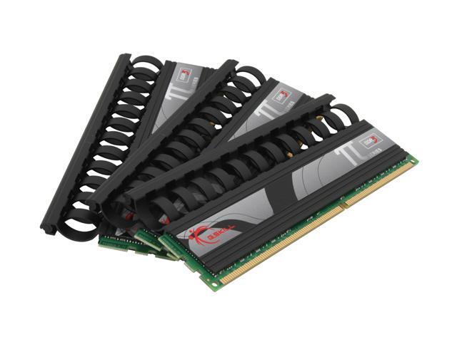

My RAM has a tall heat sink like these
And it appeared the Noctua would bump into these heat sinks. My other option was a V8 - but I really like the Noctua.

Does that CPU cooler overhang over the RAM on your MOBO?
It's close, very close, but the fan will not interfere with TALL RAM.
The camera angle wasn't perfect so the cooler doesn't look straight but it is,
and there is a good 1/8" of clearance.
