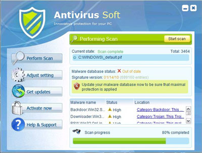

My computer is infected by Antivirus Soft, which looks something like this
http://www.precisesecurity.com/wp-content/uploads/2010/01/antivirus-soft.jpg
I CANNOT access the internet at all, although if I press IE random X rated sites will pop up. Literally any program I press on, like Malwarebytes anti-malware, or CCleaner, a notification saying that the program is corrupted pops up..
What should I do? I have A LOT of important stuff and I haven't back-uped recently. Am I gonna have to reformat?
