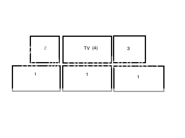

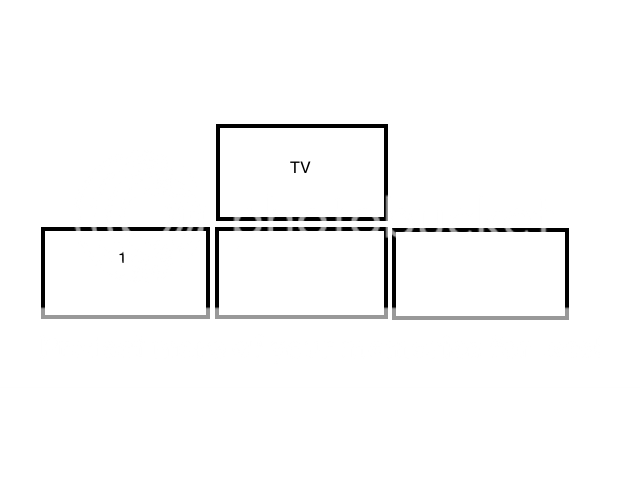

I currently have 3 22" monitors and a 22" hdtv mounted on a 2x3 monitor rack in this set up:3 monitors on bottom and the hdtv directly above the center monitor exactly like the "3x1 landscape plus 1 extended"
however i dont have the 3 eyefinity-ed together yet (just installed last night). i would like to get 2 19" used dell monitors and place them on the top on each side of the hdtv so it was a 3x2 set up. Like this:
Potentially this:
My question is can i eyefinity the bottom 3 22" monitors for gaming and just extend the 2 dell monitors that are above? with potential of using the hdtv as a 6th monitor and also keep it extended? if so what hardware would i need to connect 6 monitors to one card?
