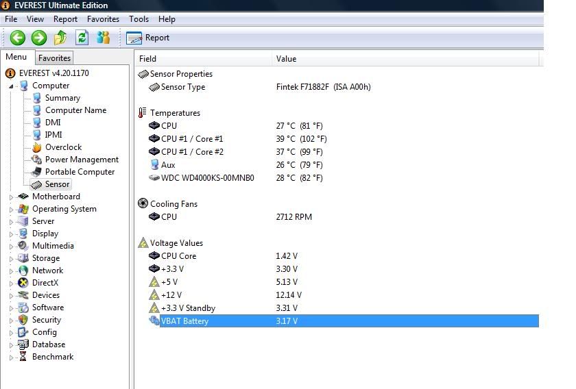

okay what i might do is clean off what iput on,but re-apply it get some cling film and wrap it round my finger, use my finger to spread the paste to make an even layer over the entire IHS and see if that makes any diffrence.
if it doesnt im going to try the Akasa cooler again.
Theres plenty of Mx-2 in the tube so.
Heres my temps now.
