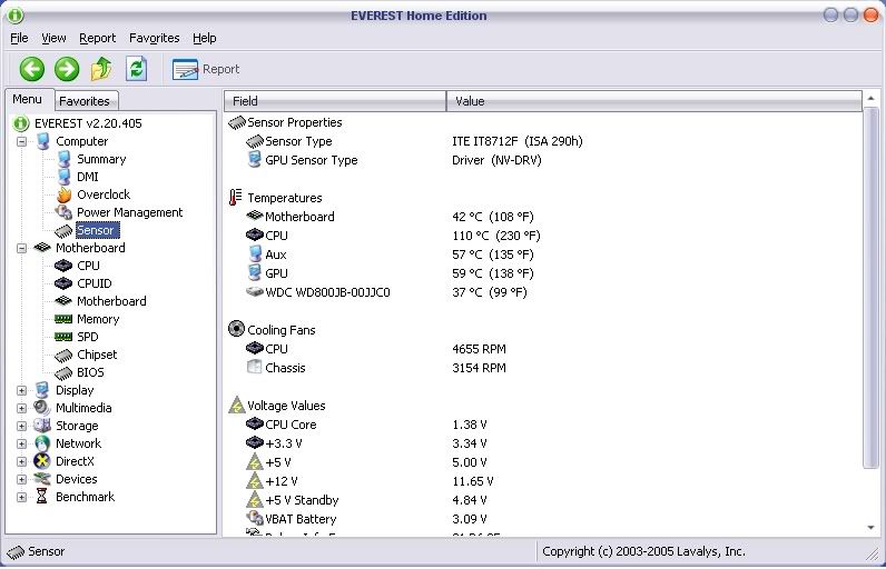

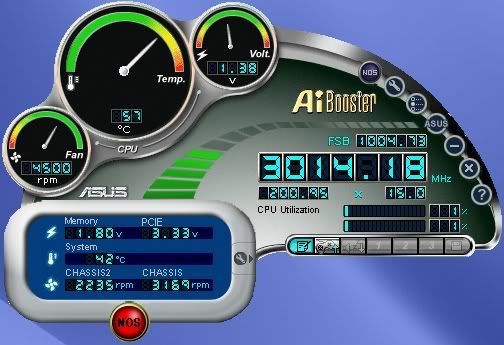

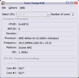

Ok, soooo i'm kinda ticked. I got my zalman today, installed it w/ AS5 and booted up. Jumped into bios and saw my temps at about 38-40c. Get into windows and see anywhere from 44-48c off of my programs. Needless to say I was mad. So I pulled it off and it looked like I had a little to much AS5 on there, so I respread the stuff on the proc and cleaned the stuff off of the HS. Put it back on, SAME THING. I really dont get it now, could I have bad sensors or something or could it really just be bad cooling. Because I just noticed that my chipset temp is about 40c right now, which seems high to me since it has the full heatpipe passive cooling system WITH the optional fan on it. I know the AS5 does take a little while to work in and could drop a max of 5c over time but that still isnt even close to what it should say. Should the heatpipes on my HS feel hot, because right now they dont at all. Could that mean its not transfering? I'm just so mad right now because I took a ton of time to clean all this with the AS cleaners and everything.
