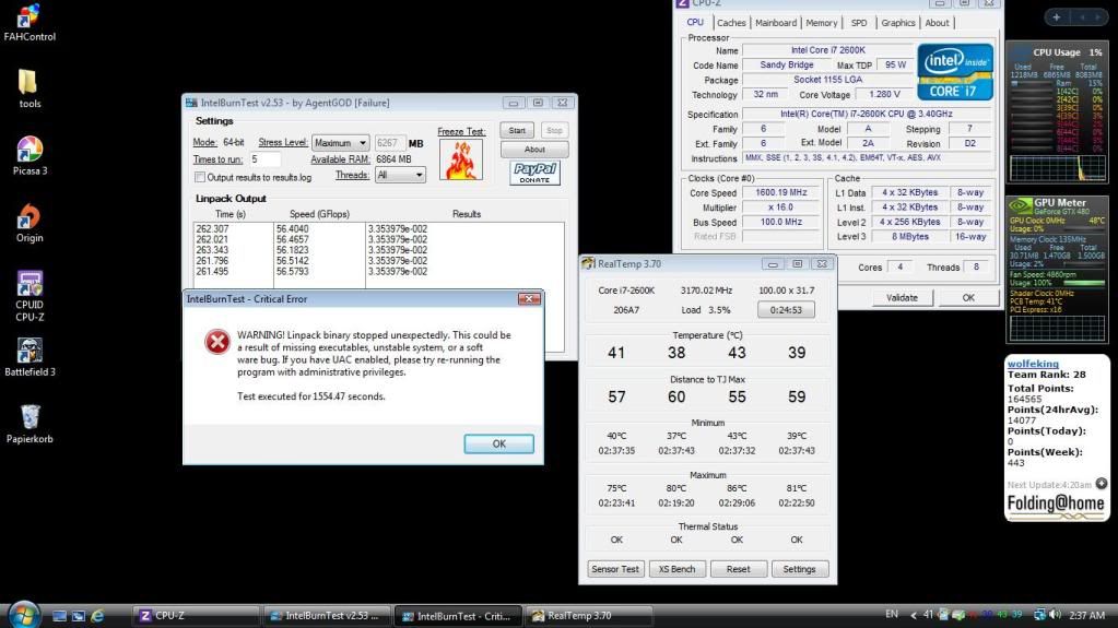

The top 2 being intake would mean turning the cooler yet again. Its not worth it for a few degrees difference, as that will still not make it boot on 4.4 or 4.5 @ 1.3. Higher voltage makes lots more heat.

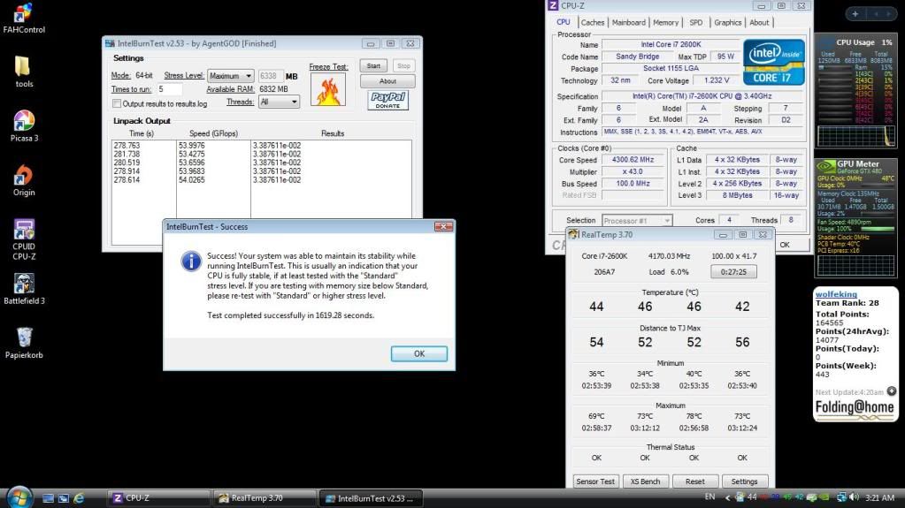

@ jonny, it only lowered the temps about 2 degrees. Going to drop it to 4.3 or so and drop the volts to tuck it back under 70.
@ Jason. Hmm.. Might get one. Don't know. my dream system is not here quite done just yet. The case sucks, the user is not the best, and its not got enough storage space. Not to mention all my data, songs, pics, and stuff is on the failing Toshiba drive. Going to stick it in the M90 in a bit and see what I can recover. Then I am going to need a quite big drive to store stuff on. But that is farther in the future. As for now, its a SSD, and a fan to do push pull on the HSF. That might bring the temps back down on 4.5. I think I can do 4.3 stable and right at 70. I am getting 74 to 76 at 4.5 under burn test.

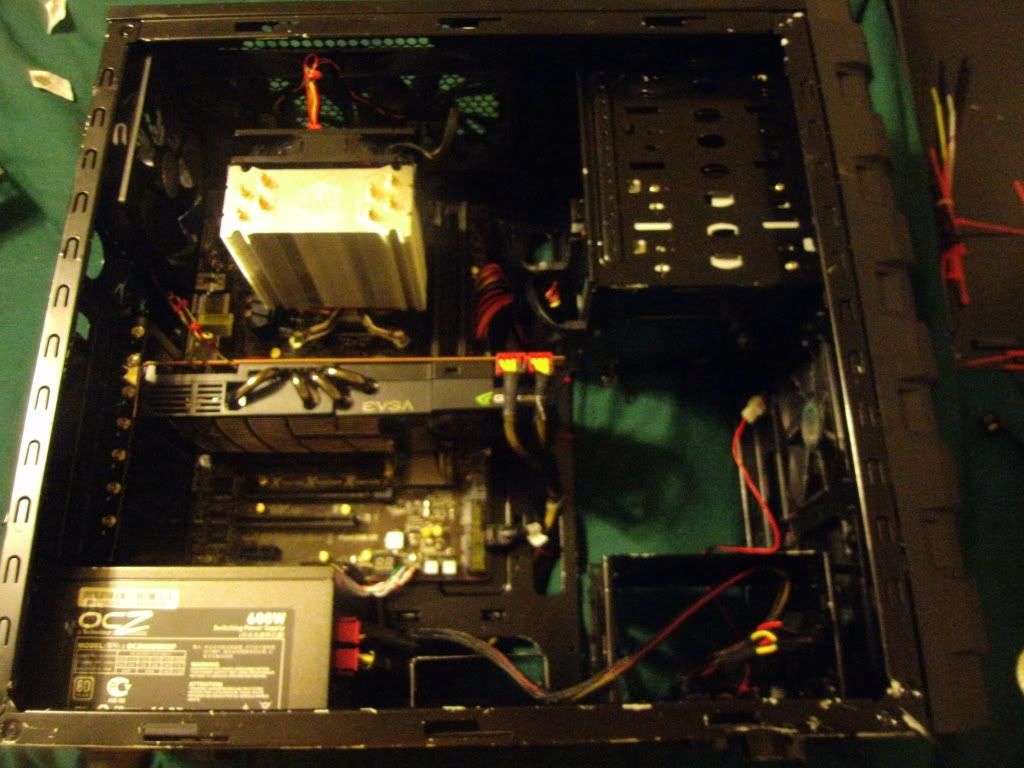

is how its set up now. Got all fans powered now. Intake on the top and front. Exhaust out the back and 480 vent. Temps dropped some. A little at a time.
I wonder what the difference between the 26-- and 25-- in terms of heat is down to. I managed 4.3 on the stock cooler. Our setups are fairly close, you've got a cool case but a hot GPU, and I've got a hot case but cool GPU... Does HT actually add heat? Weird.

Side note - your cable management is looking pretty good, better than mine!

Not really sure about that. I have HT on, and currently am running 45x100 and doing fairly well. Im testing it now and trying to get the volts down. Running 1.300 on it right now and running intel burntest for 5 runs to see about heat.

One thing I am noticing and it may well be this board, is that the core voltage is not stable. Its set to fixed voltage @ 1.300 and it is running between 1.300 and 1.315. :(

Your voltage issues could either be with the board or the CPU. Sometimes you get chips which just do not overclock well at all. Could be a board issue I guess.
Well, it seems to hold an OC pretty well. The board is questionable, as it has been practically from day one. But eh, find out soon enough.
Trying 4.3 @ 1.250V to see how it runs. May be more stable and cooler. And 200 MHz will not make a big difference for most things. May get a H80 for it, not sure if it would help.

4.3 at 1.250V should be fine, give it a go.

just don't forget you siggy, and i'd stick it on like a 20 run loop or run prime for a while overnight oneday just to be sure it is stable.
