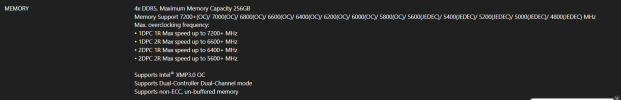

I would leave it disabled and run a memtest. I just researched your motherboard and realized natively the board only supports ram up to 5600mhz without an overclock so if the ram already is 5600mhz then you don't need to enable xmp.

According to that it natively supports up to 5600mhz without overclocking. So not sure why bios is only registering at 4800mhz unless the new ram is 4800mhz and not 5600mhz. When you run only your original ram, what does bios say speed is? Try using both sets independently and check to see what bios speed says. XMP is used when you use ram higher than what is natively supported. XMP is not needed when using at or below native max speed.
