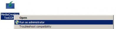

6)...I decided to start over and attempt to DL Windows 10 Home (what is in this unit) ISO , and here is the start of my problems....I tried utilizing the "Windows installation tool" but, get an error each time I attempt to use it....Scrapping that idea, I will attempt to use "RUFUS" to create the USB boot-able media creator.
7)....CURRENT PROBLEM IS: I SEE NO PLACE THAT I CAN DL IT W/OUT THAT DAMNED WINDOWS MEDIA MAKER INSTALLED!
Is there another place to dl "10" or somewhat of a work-a-round to get the ISO?

That program will download the iso to the flash drive???
Yes, all you got to do is follow the prompts to do it. You run the tool and follow the prompts to create the usb drive. You aren't saying what this error is you are getting. If you actually did a factory reset by using the " reset this pc" option then you should be back to factory providing you chose to remove all data.

will post pict in a min or so...
voyagerfan99
Do you have anything newer than Windows 7? That's probably your issue.
Da Mail Man
I think I do on a laptop (win 10) but, I don't want to corrupt anything there...To clarify, the usb creator tool will dl the windows 10 iso to it?
Da Mail Man
**It may have been the OS....
I dl'ed the usb tool and am dl'ing the iso to it as I type...Will see what happens......
MS should have posted this "exception" in there web pages to prevent confusion.
As long as you don't choose an upgrade or update option it won't do anything to your laptop.
Da Mail Man
It was slow-going but, using a 64bit computer I was able to effectuate the restoration and tablet i working.....
I did not do an upgrade or anything as such....Loaded the os and all into the flash drive and then, into the tablet....
