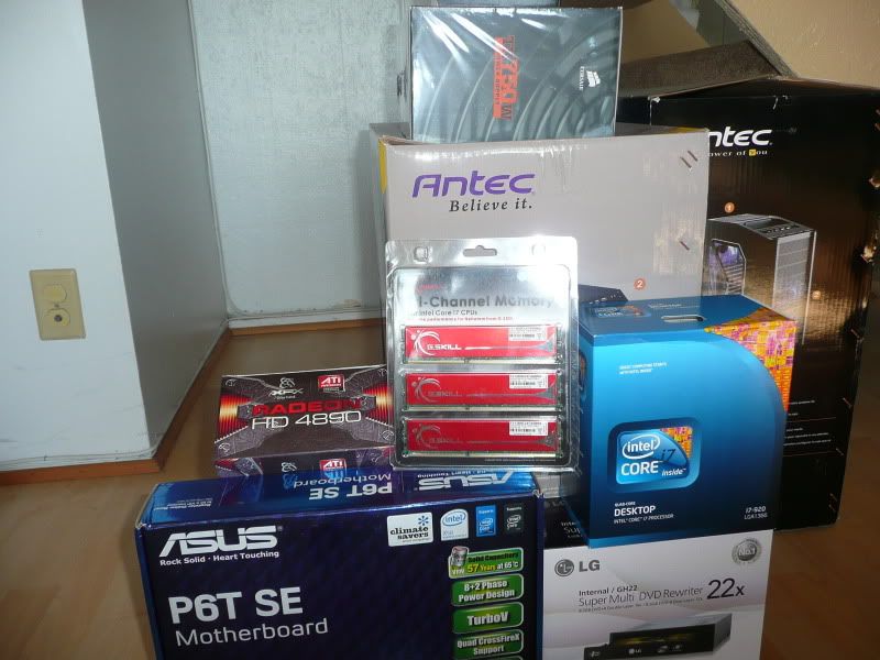

I got my i7 920 today and now i have everything I need to get the first computer build going. So here's a picture of everything. It shouldnt take me long to get this bad boy squared away but once i get a keyboard and mouse today, i should have everything installed and test everything out.
Yes there is an Antec 900 next to the 902 but I will use the Antec 902 for this build.

dam thats nearly identicle to my first i7 build
i got
i7 920
asus p6t se
g.skill 6gig ddr3
xfx 4890
coolermaster 700 watt psu
antec 1200
unfortunatly my mobo was DOA so i purchased the foxconn flaming blade
